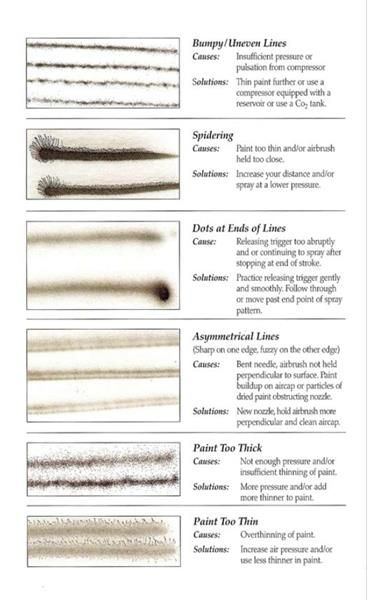

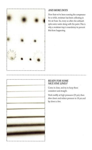

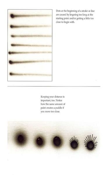

    I found these online. Great visual hints and tips of the basic airbrush problems and how to fix them...
    wedmodelfactory.com
    Very neat.
